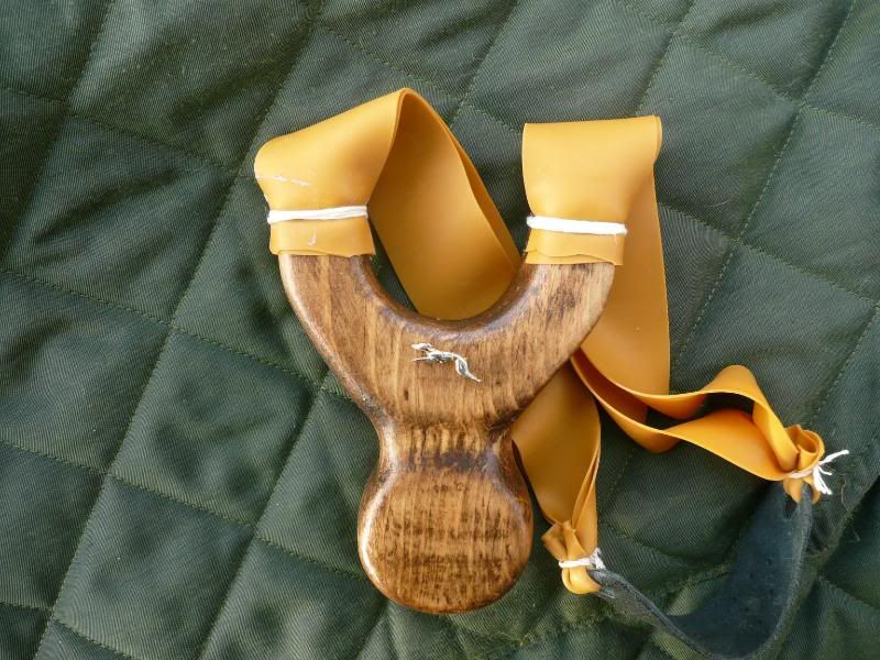

Well Ive just finished my 1st cut catapult, how about this bad boy, the lad im given it to is a strong lad so should suit him, i tried it out this morning and im going to make myself one now, hope you like it jeff,

Very nice!
I have two small issues.
First, I recommend the rubber strip method for the fork attachment. Just cut out a small (4-5mm wide, 10-15 cm long) band of Thera Gold, then wrap it around tightly. This is shown in this video:
This attachment is super strong, easy and can be untied in just a second-
Second suggestion: Use the constriction knot for the pouch attachment. It looks like you are not yet doing that (but I may be mistaken). The constriction knot is the ideal one for the purpose, I can not recommend it enough.
You can learn how to tie it here:
Thanks, Geko, for these great videos.
Jörg

Thanks for the advice, i wasnt too fussy putting the band on cos the lad is going to order a couple of bands of Fish, i think, they are a few old ones i had, but will take the advice for when i put mine on, ive been shootong catapult for a good few years, but never been on a slingshot forum, and have been suprised by all the bad habets i have picked up, i seen your video on you tube and enjoyed it so joined the forum, cheers again jeff
just watched the knot video , i know that one i learnt it in the scots 45 year ago ha ha

I like it what is that inlay you have in it ...pewter? where did you find it. i have seen several people use those and i would like to get some for my slingshots.
anyway good job i really like your design I am partial to short squat cattys
Ha Ha its 9k gold, its a old earing, but you can get the pewter badges on ebay, i sometimes put them in the natural branch one i make, they are easy to put on, i cut a little hole in the wood, and inbed the clasp into it and glue it, jeff

I love that catty.....looks like it would ride in your pocket all day until called upon to invite something unfortunate to be the guest of honor at dinner. I may try to duplicate it when I get the chance.
Thanks for replys, tried it out yesterday, shoots nice, bands are a bit strong for me, i am a better shot with lighter elastic on, but the catapult has been sent away to a friend, will be just fine for him, thanks jeff
