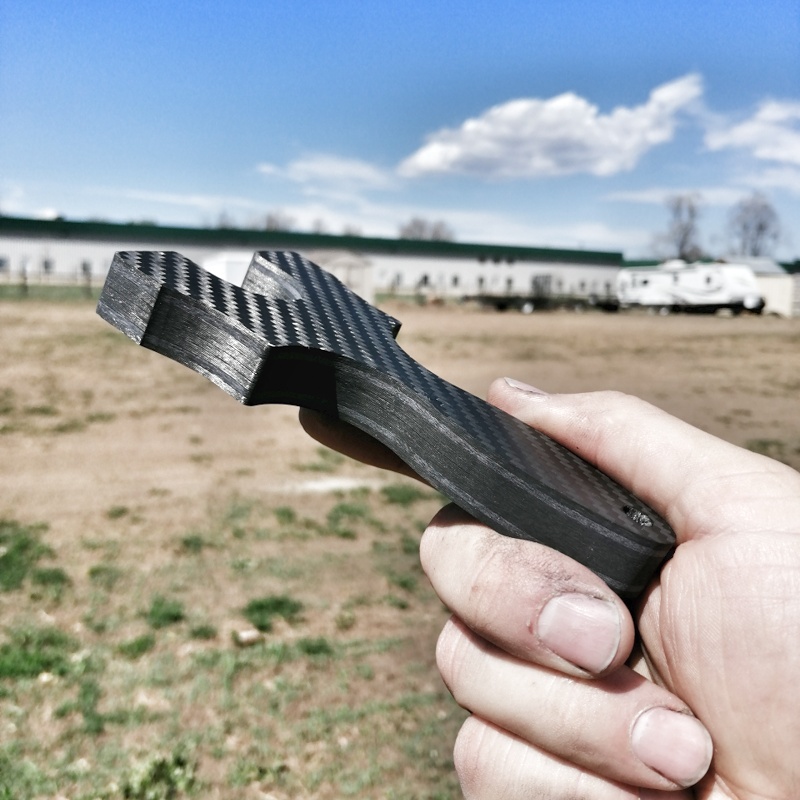

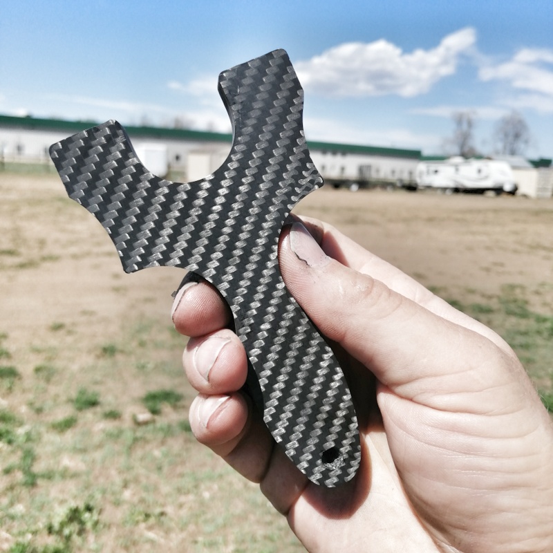

I had some CF sheet laying around the shop so yesterday started to make my first slingshot.
I made a simple design in Fusion 360, then milled out some carbon and G10. I then glued it up and let it sit over night.
Today I cleaned it up a little and here's what I have so far. Still need to do A LOT of shaping, but I think I am going to like it.
It is going to be a small OTT slingshot. It has a 4 mm carbon plate core then a 2 mm CF sheet, 2mm G10 sheet, then finally another 2mm CF sheet, making it 7 layers in total.
I think this is going to be pretty tough to shape!
41 Posts
Finished it up!
I think it turned out kinda decent. I could have shaped it a little more, but it is comfortable to hold and very smooth. Finished it by wet sanding with 500 grit paper, then buffed it with a wheel and buffing compound.
