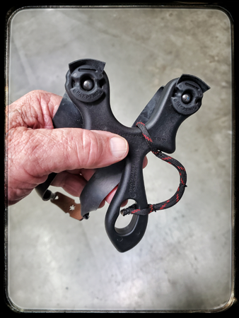

I used a piece of paracord to make a couple of mods to make this Ocularis system very tube friendly.
The first thing I did was run a ~3.5" total length and then folded paracord piece through the Ocularis allowing a looped tube or single tube with a loop to be used in a OTT configuration. This system allows me to use the same tube length for all my slings --- A real plus !
They Ocularis can be reversed and a shorter paracord loop can be run straight through the Ocularis and used as a shoot between the forks method if you like. Using this way your draw length is maybe lengthened just a bit as the tube/attachment point is closer to you. .
This system of using a paracord piece allows for pretty fast elastic change without tools and fast changes between flats and tubes.
Pic below of paracord attachment method:
Above are the heated ends that keep the paracord in place, in my testing it has not moved at all !
Looped paracord going over the top for OTT shooting !
Looped paracord going straight out for Through The Forks shooting if wanted !
There are many positions to mount the paracord, it is all up to you and the way you shoot. For added security the Ocularis steel ball can be put in place if desired.
