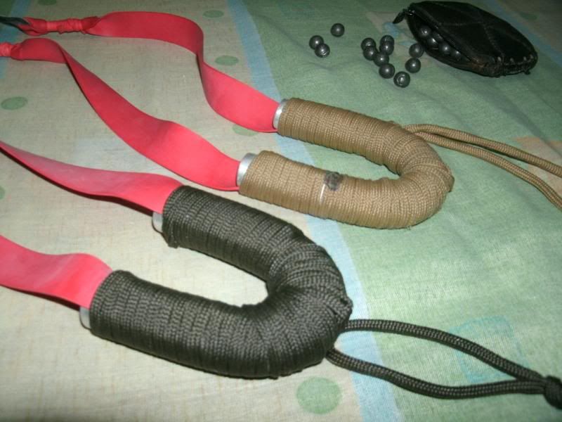

iam new to this forum and i'am glad to have found this site, its been yrs since i held a sling shot made by my father and recently i've been wanting to shoot again this old hobby of ours,cause i want to add it to my bag out bag,, so 3 days ago i made 2 sling shot and it took us half day just doing this 2 sling shot,
i call it my u-shot, cause of the obvious shape i wanted and i want it to be compact and tough and light , so since i got lots of alluminum t-6 round bar in my garage, me and my son started to bend this 2 slingshot frame, 1 is a 5/8" dia and the other is a 3/4" dia, a friend saw us and said that the material is an overkill for just a sling shot, but i said i want it to be sturdy, he just laugh and said it a nice project.........
then when we were bending it, this 2 allum is one tough bar to bend, hahahaha, i want it to be powder coated (since its allu) but i opt to wrap it with para cords,

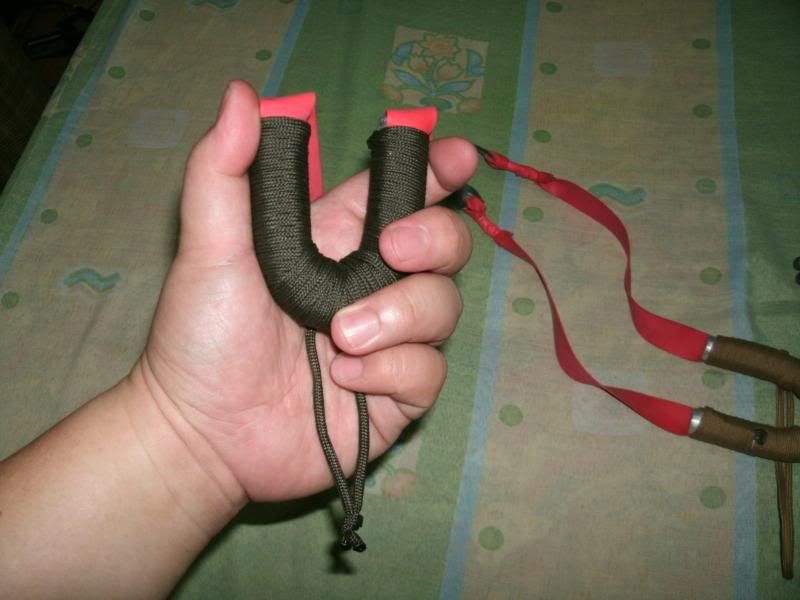

here's the pic and hope you like it

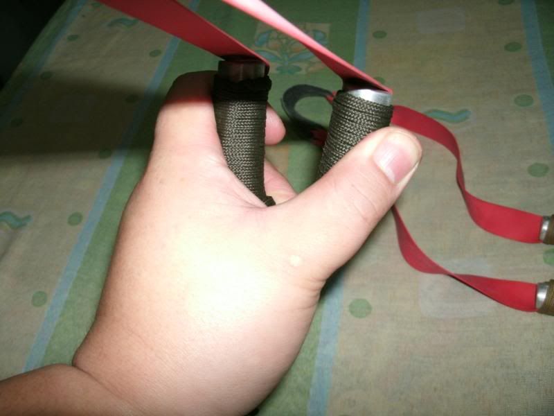

this is how i hold it, also all corners were rounded and polished
this is my ammo, i was able to buy this lead balls long time ago, i think i have 3,000 plus pcs of this lead, this was due to a fishing store closing down, he sold it for a very cheap price,

i have to make it simple 3.5" high and 3" wide to be simple and compact for my bag out bag, i think sling shot is the best back up for emergency to get small game out to 20 yards or more,
but i think i have to make a similar unit but with a hollow or tube t6, so i can store some lead inside, hahaha now my brains are running

ok if time permit, i'll make a vid of my shooting practice but yesterday i manage to shot this slingshot for an hour and after more than 100 shots , my hand is not that fatigue,
cause i also thought that shooting it too much maybe 100 shots, my hand will start to suffer cause the u shape doesn't have the notch like the normal y style frame that we normally have, so i guess that it will be more hard to my fingers, but luckily it does not, my hand is little bit tired but not hurting, for a day hunting purpose for my bag out bag, shooting 100 rounds is too much,
i can easily hit the small milk can target at 20 yards with my setup with a nice power full force and with a roughly 70% accuracy,
