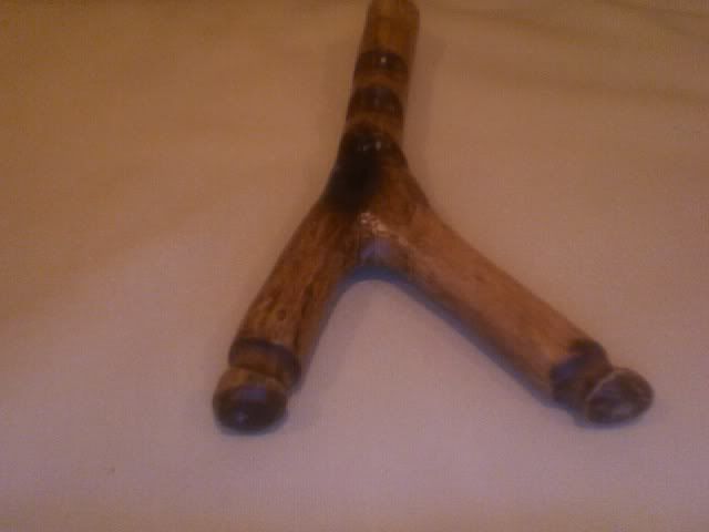

Found the nice fork at a friends house. It's a variety of light walnut and is very hard. This slingshot was my first venture into natural forks. They are a lot of fun to make. I never would of guessed what was under the fork of this slingshot. To bad that it's a bit of shaped. First thing when I got home from my friends house I started to carve the shape out, and it shrunk. So I put it in the microwave for a two minute session. All of the sudden I heard a loud explosion and notice the microwave door blew open and smoke was coming out. So I went up to the microwave and there was this red liquid everywhere(how weird). So I cleaned that mess and started sanding. I finished It in poly urathane with four coats. Sorry for the bad pics. Can't wait to shoot when I overcome the flue. Dan

Dan it looks like a cool fork to me. Walnut is always good. Fork tops look nicely smoothed out. Did you band it up and shoot it yet? I have been making slingshots since July, and just in the last month started shooting them before finishing. It gives me the chance to really check out the grip and make changes if needed. Don't know why I did not do it before, DUH! Dayhiker and JMPSLNT can give a better review of it I have made only a few naturals. Did the microwave survive?

Where that's a bit on the thin side, I'd be afraid of what the microwave might have done to it. Could have been burnt out on the inside and be dangerously weakened. I'd put it to a test.
Very nice looking fork, though.

I'd agree with DH on it being a bit slight in frame, yet if you deem it sound, then so be it, I have no right to argue as I can't see it first hand....
Good job overall, although in the future I would suggest avoiding the microwave. About 3 of my last 5 naturals have been dried using an unnatural speedy process. Yet, for 2 of those 3 I gave them about a month to dry naturally to start off. From my experiences to do a "fast" dry I would suggest a long bake on the lowest setting in the toaster oven or the oven. This has worked for me, as you are basically "sun baking" them, which is practically thinking, is slower, safer, and more thorough.
