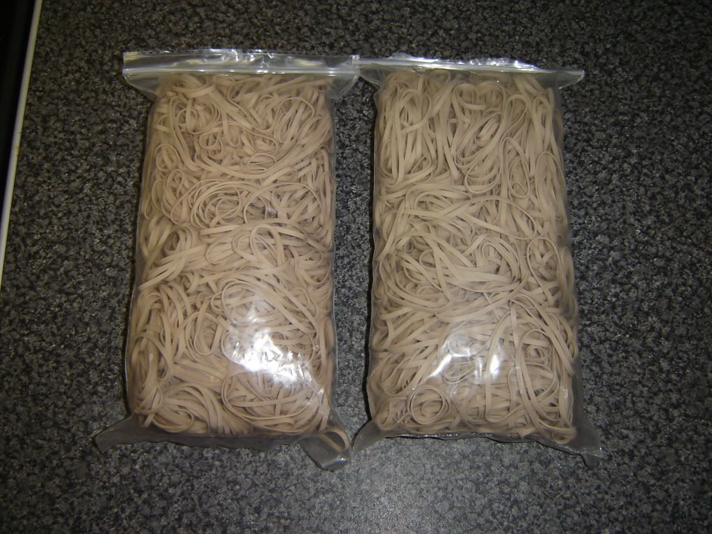

I hope this helps people in the UK to make their own cheap chained rubber bands. You want to go to any office supply centre to buy your rubber bands and i went to STAPLES to buy these. Two sizes #33 & #32 it cost me £6.60 to buy both these bags of rubber bands. Thank you Jeff aka ( shot in the foot ) for pointing me in the right direction. Thanks goes out to Jamie and Nick for posting how to make chained rubber bands band sets. The cost to make a set of chained rubber bands for your slingshot is only 10 to 20 pence each.

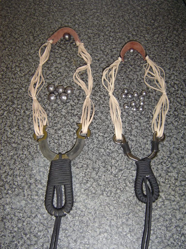

Below is a Cougar and another chinese slingshot fitted with chained rubber bands. They are great for target shooting, Hunting plus both will shoot .44 cal and 16mm lead balls.

Why did you buy 2 different sizes? which is better?
Cheers
I brought two different sizes because thats what was on the selves in STAPLES. The #33 are longer so you need less to make a band set but you get less in a bag, #32 are shorter but more in a bag about 900. If your hard up for cash or a young child you can still make top notch bands very cheap plus they are available everywhere in every country

Good post Lucifer. I am happy to see some shooters at least giving these a try and also to hear of others having their own experiences with them. While I accept the primacy of Therabands I feel there is a place for these in Slingshot World. Their extremely low cost. ease of procurement, and the great simplicity of creating decent bandsets have endeared them to me.
Seeing dankungs strapped up as such is also interesting. I've enjoyed watching people go their own way and add their own flavour to the chains. You said the cheap 32's shot those lead round balls fairly well? Please let me know something regarding this.
Finally, I must direct all your praise regarding all the chains to Nico; he's El Jefe de las Cadenas. He's the one who set me on my path (after some initial resistance on my part) and his low-cost resorteras have been a huge influence on my slingshot making. I have tried to resurrect the Gypsy Tabs to some degree but he's the Master of the Chains. I'm going to try to find some game when I get off the boat in another few days as the weather is finally cooling off here in the US.
Take care, enjoy your chains, and keep us posted.

chains are excellent I only use this rubber. I also get my bands from staples they are cheap and functional. check out my videos to see just how well they shoot... they still suprise me even now 170 fps with 8mm steel for something that costs 10 pence no wonder this is the poor man's shooting sport lol I'm proud anyhow.

I actually did this same thing too. At first I was chaining the rubber using the other method (where they are just looped into one another, not sure what that is called) and I was getting no speed. Then I tried chaining the bands like Lucifer did above. Now they actually shoot pretty fast! I am using #33 bands and they are super cheap at staples.

I do mine a bit differant, and i taper mine start at 9 bands a side and end up with 6 at the pouch, jeff

Thats a cracking catty very impressive and I'm sure it has good power too..
Some day we may have to do a trade if your up to it, I can make you a Mexican style chained catty and you make me a UK style chained catty.

I wanted to clarify something about the style of tapering I use with the cheap staples office bands.
As my chaining is 3 links I have obtained a very effective taper with the #64 rubberbands by putting 4 at the base and then 3 and 3 in the final links.
With the 433 chain using the #64s I was able to achieve with a .50 cal lead ball velocities of 168 - 173 fps
I'd say thats more than enough power to down prey with.
Here's a resortera with this set-up on an antler fork
Yellow Metal Fashion accessory Pattern Wood
I already noted the type of velocities achieved with this kind of chain taper using the cheap #64s and it shot very well with 1/2 ounce lead balls.
Hi Luxor,
If you care to take a look into some of the velocities I have achieved with the red #32 rubberbands I posted some info with chrony pics on this older thread titled "more on chains"
http://slingshotforu...more-on-chains/
I think you may be surprised at how strong the red version of these rubberbands can be.
