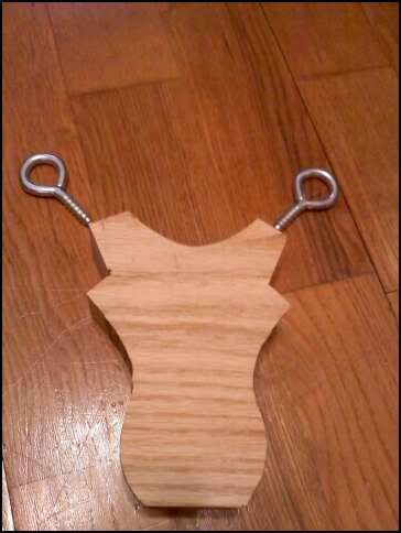

Here is the other work on progress that will not be finished until I return to the shop again. It is inspired by my thoughts of easy band attachments, Holzwurm's shared pocket shooter ideas, and the frames of dankung. I'm quite happy with it's shape and size even at this crude stage. I only had enough time to pick out the eye screws (I'll bend them out a bit later) and cut it out. This oak is really where the jigsaw struggled, but I made it through without any major mistakes. Here it is, with absolutely no work put into it other than cutting out the shape.
The eye screws will go in and then bent out slightly so I can slide in looped bands etc in easily. Also, is the grain direction okay? Quite honeslt it's such a compact, small, and thick frame that I figured it would be a problem whatsoever, the wood itself is nicely aged oak that is 1 1/8" thick at the moment......can't imagine that breaking!
Though rough, it really feels nice in the hand, I love the chubby feel of it and the little finger rests give it optimal control
Many thanks go to Holzwurm for sharing his ideas on this type of design and inspiring me to do something similar. Thanks for looking, I'd love to here some of your feedback on these, as soon as they are finished I will update the thread with pics.

John, the grain is going the wrong way. Otherwise the design of that little oak one is very nice.
I can't say anything about the phoenix until you finish her up. Looks strong enough though.
3,427 Posts
John, duuuude, you're buzzin'. It's nice to see someone so into this as you obviously are.
Yes, the others have a point about grain ... however ... In this case you may get away with it. I say that because you are using good sturdy wood and a thick ***** of it; the arms are very low and reinforced with screws. Nevertheless, be your own judge of safety. A veneer, ideally micarta or G10, on the front would contribute greatly to safety.

Ahh Jeff, thanks for the input on the eye screws, I thought of that fact myself in the beginning, but as both of these are really trial runs at these designs, and I only had these screws laying around......they will do. If you use the rings a lot then that gives me even more assurance that they will work well. I'm really excited by the prospect of a very easy, quick, and permanent attachment method for my chains ans looped tubes.
As to the grain, I figured it was wrong, once I got it cut out I realized it...
But, quite honestly, this little sucker is not going to break...its very thick and stocky and the oak is of good quality. The forks are low and there isn't really much of a weak-point where it would most likely break. I'm not going to worry about it on this one, none of my bands have draw weights over 20lbs or so, and this is certainly stronger than any natural I have. I appreciate the concerns and identification of the obvious fault, but from my evaluation, it'll be fine, over and inch of oak doesn't just snap off at one point without a great deal of persuasion and force.

if you use them rings turn them round so the eye is facin sidewards, then the band or tube will sit in the middle of the hoop, and not on the top, it give less strain on them, like this one, jeff

Thanks Jeff, I was planning on turning them that way, its just a bit difficult to display the them to everyone that way when not already screwed in..
That's a good looking little slingshot you've got there as well. It looks like the stocky design with a palm swell will be similar to that of mine when finished.
And thank you again Jeff and DH for the tips for the screws. I can see why bending them this way would sort of lock them in place, and some epoxy surely couldn't hurt.
