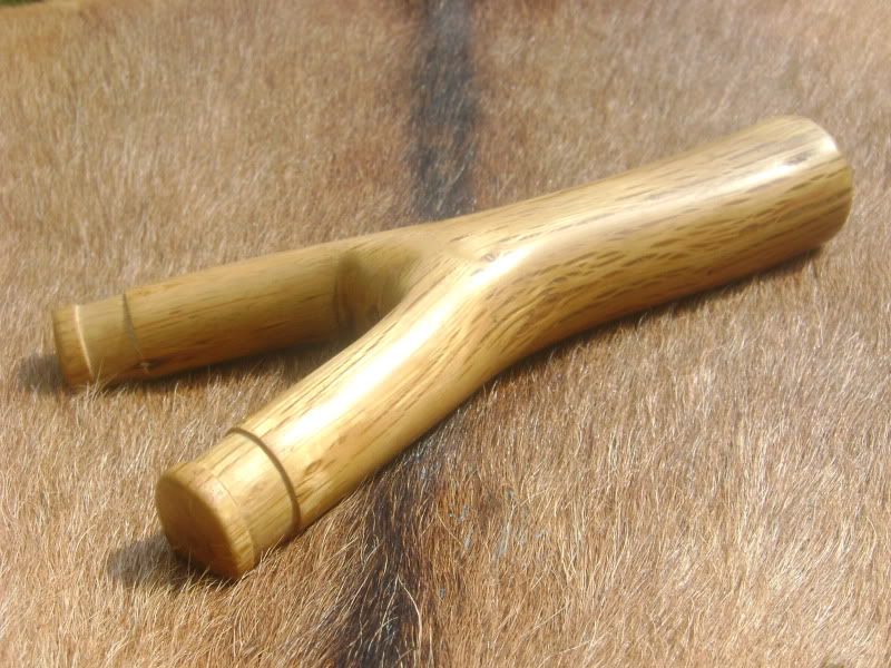

This is my first natural fork and is made out of huizache, a plant similar to mezquite. I carved it from a very large branch, I found on the streets, it was cut maybe two days before I got my hands on it. I used the burn method to dehydrated the branch, but I did not do it right, so after I finished it started to show cracks in diferent places, specially at the end of the poles. I still like it alot and I know because is huizache and its thickness that is not going to break. I made it very ergonomic to my left hand, so it fits me very nice. I have to reconize that my first slingshot natural proyect failed. Since is very pale in color, I named it after a cartoon caracter very popular in Mexico, named "La Catrina" a drawing from the master Guadalupe Posada. La Catrina is a wealthy lady dress with a Victorian hat and is all but bones or dressed with a Victorian dress. This is also my aportation to the Mexican ancient celebration of "Dia de muertos" (Day of the dead). Greeetings...

if you have another piece of that you could mix some sawdust with epoxy to fill the cracks, or if you havent sealed it or put a varnish on it you could try soaking it in something like linseed oil it might swell the wood enough to make them less noticable. ( but you might want to check on that with the people who use linseed oil to finish theirs...)

I wouldn't tag it as a failure... seems very nice and those cracks can be filled with superglue (aka kola-loka).
Nice shape and the huizache truly will resist even with the cracks.
Mi estimado Xidoo, comprate un botecito de kola loka y deja caer algunas gotas en la cuarteadura y déjala secar, ya seco, pon otras más... y así, hasta que quede completamente tapada la cuarteadura e incluso sobrepase un poco el nivel de la misma.
luego, dale una lijada para que quede a nivel y listo.

Thaks, HiCS for the advice to fix the cracks. I never thought about crazy glue to fix the problem. Saludos.

Don't try to hide the cracks, make them stand out. Get a red or green or blue ink pen, take it apart and mix a drop of ink in with some 5 minute epoxy to a nice bright color, then fill in the cracks, let it set good, and sand back down. Call it an accent stripe.
PS most ink sets CA glue instantly, so there isn't time to fill in the cracks after mixing.

This time I must state that I disagree with you. I have "La Katrina" with me, and It does not look like any other resortera I made. It kept cracking, so it has very deep cracks, but won't break. If I have the same fork again I will make a totally different resortera with no cracks.
I must state that I have kept this resortera just because is the very first one I made. I do not feel very proud of the results I got.

Minor cracks add character but as 93 said, super glue will do the job. Leak it along the crack then sprinkle some fine sawdust from the natural itself onto it and smooth it down with a finger. It will then sand down to near invisible and the crack will be stable. Thanks.
