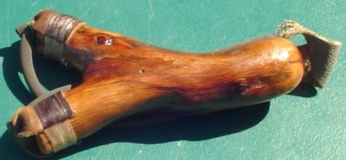

I have this totally awesome slingshot I got in trade from Jmplsnt (on this forum). This thing is one of my very best shooters, and the rubber tube on it is amazing. It's a soft pull and doesn't zip the ammo out too fast, but it can still deliver a good wap! to the target. It is rigged in a style he calls "Gypsy" and is modeled after the way they do things in Arkansas, I think.
This slingshot is rigged with a large pouch for shooting stones, but shoots everything just as accurately as the carefully engineered ones as near as I can tell. I really love this fork and it is a serious contender for being my favorite.
A leather strip of shoe leather is held in place by windings of waxed dental floss, coated with super glue. The tubes are tied with the floss, too. I wish I knew the wood.
One of the most amazing things about the tubes to me is that this is the 3rd slingshot Jmplsnt has used it on, and I have at least 500-600 shots on it! Seems indestructible.

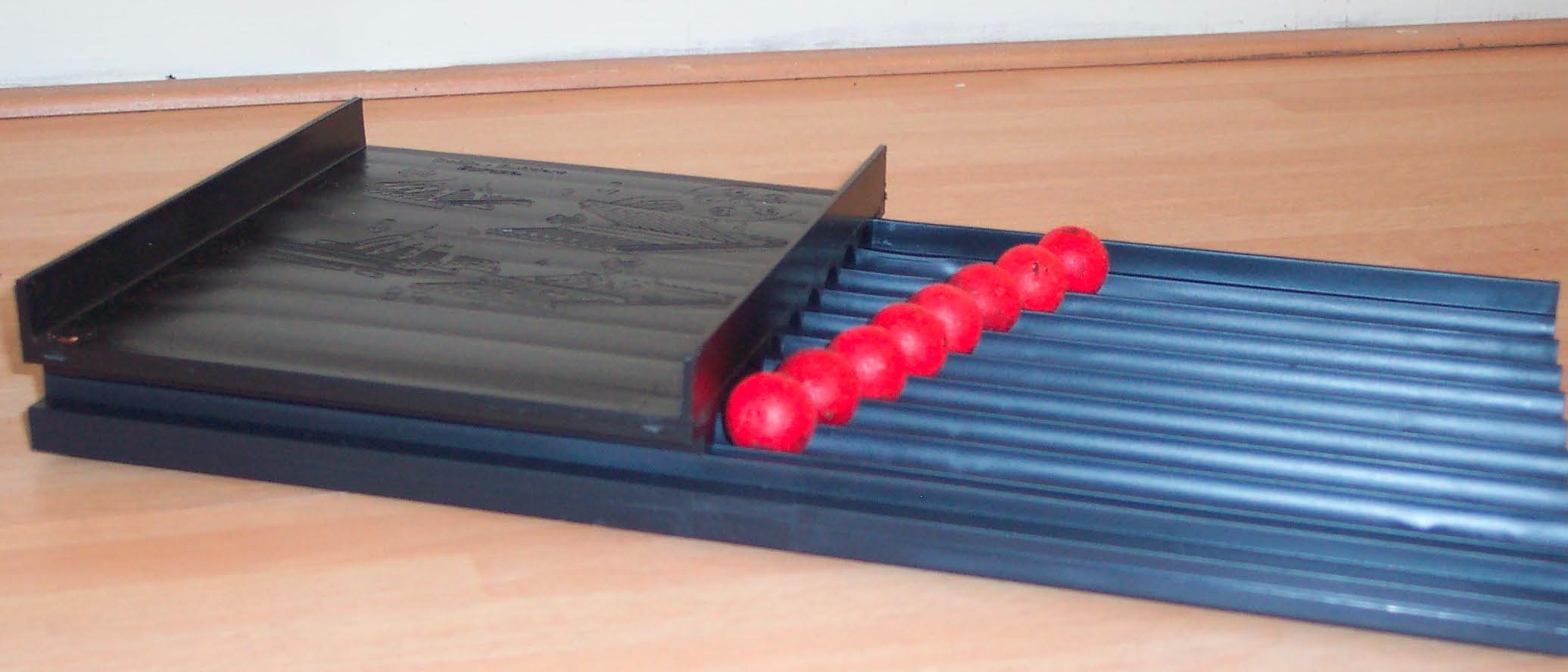

OK guys I've just blown the dust off my boilie rolling kit, for does of you who aren't familiar it's a simplistic device to used quickly and efficiently roll multiple 14mm, spherical baits simultaneously, the baits are then boiled to harden them so that they're suitable for fishing hence the name 'boilie'. Any I'm interested in trying to use to roll some clay, what do you think?
Here's a picture of one, to give you an idea of what they look like...

Yeah, I was going to suggest using a bait roller too... good call Sam!
You can get a real nice one of those at: http://www.wackerbaits.com/sf/contents/en-us/d111.html $57.49 for the large version that can produce thousands of perfect round clay balls in an hour or for the smaller/portable version $22 plus shipping isn't to bad.
I've done a little sculpting in my life and so I know a little about curing clay.... you won't need a kiln for this... just put them in your oven for 90 minutes at 500 degrees... and you'll be set!
No matter how well you think you're rolling the balls by hand you're going to have slightly different sizes, weights and symmetry.... rolling them out using a machine is for sure the way to go...
But if you do insist on doing them by hand.... First at least roll out little sausage snakes, that are as even end to end as possible... lay a ruler next to them and cut it into even pieces, then roll into balls with a bit of water on your hands.

This slingshot is made from blackjack oak. This is the proper, scientific name for this species and not some ******* colloquial name. It has a very dark red wood but normally the logs are hollow and worthless for lumber. Thus, it's despised by people where I live.
I call the leather tabs attachment "gypsy" as this is how slingshots made in this manner are described on ebay uk. I have apicture library with 3,000 slingshot images minded from all over the interenet for review purposes when making my projects and to keep track of them I have to have some organisation. So, I have named them "gypsy" though I think you would see this style all over the world if you looked hard enough. I even have a few pictures of the flip-style Guatemalan forkless zoomorphics fitted with leather tabs. I like this attachment as it allows the use of tubes or my favored chained rubber bands of which I will speak of more in the near future. They serve to make a slingshot flatter and fit in the pocket better than tied-on bands, at least for me.

John, you just reminded me: I have a big hunk of clay sitting in the closet, I hope it didn't dry up! I highly recommend the clay balls. You can roll a nice big supply of them in a couple of hours. Like stones, you can't depend on their flying straight. So in my opinion they are no good for honing your sharpshooting skills. But they are a lot of fun anyway.
Now if you take Bill Hays's route and use some sort of machine, you will have something like a bunch of marbles to shoot, which will be good for target training, I presume. I wanted to go that route at first, and thought I was buying a boily machine over the interwebs, but it turned out that all I bought was a "table" that produces uniform 3/8-inch rods of whatever that boily stuff is. Alas, however, it doesn't do the same thing with clay. The clay is too sticky and all you get is a mess, even when you use a lot of water to lubricate. Anyway, I gave up on it and just roll by hand -- it adds a fun challenge to shooting, and at short ranges (10-15 yards) you can tear up a soda can in no time.

P.S. That blackjack catty is still one of my very favorite shooters.
