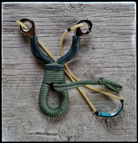

Out early in the am shooting BB's all over the place using the two slings below and both pretty much* shoot to the same area, quail are out yelling and causing a fuss, and it is a nice cool morn.
Zinc%201030%20Single%20Tubed%20Sling%20s
Chinese%20BB%20Shooter%201030%20Single%2
The BB's are peppering everything, but the 1/4" are more than holding there own, the 1/4" IMHO, are much smother shooting because of their 3 times weight difference, they are a bit slower at gitty up, but hold their velocity better ---- but for peppering your surroundings BB's can't be beat especially with a cost of about .20c for 175 shots as I remember when I bought 5 or 6 containers of Daisy 6000ea for $6.49+ tax, I think it was last year. I may go back and see if they are still available and pick up another few containers. The only ones I saw recently were Crosman but they are copper coated and don't show up as well in flight
The morning is beautiful and I'm smacking dirt clods, old cans, twigs on the ground ---- in general ---- stuff. The BB's are accurate and they are at their intended target NOW ! I chuck a few more 1/4" steels also and they are not only there fast, but they definitely hit with more authority.
I'm shooting both slings, no difference in power of course but aiming point* changed as the sling with the big pinky hole and tassel set has the tubes closer together than the green wrapped sling so my aiming point is a bit lower ... surprisingly that works out pretty good as the smaller sling has aiming marks cut into the eye of the fork and they work for me :)
